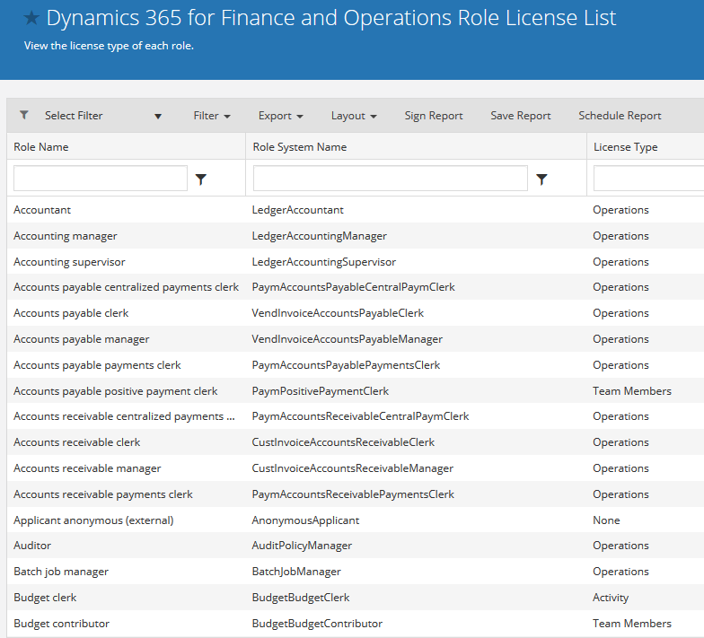

  • 3.  RE: Microsoft license & User role
    Posted Feb 20, 2019 09:45 AM
    Richard,
    I've written on this topic to give some background:
    Determining User Licenses in Dynamics 365 for Finance & Operations
    There's also the Security Role Effective Access report within the user interface that will have the license tied to it, I wrote about security reports like this here:
    New Out of Box Security Reporting in Dynamics 365 for Finance and Operations
    I can't upload the entire file unfortunately but I was able to generate a role license report from within our Fastpath tool as well.
