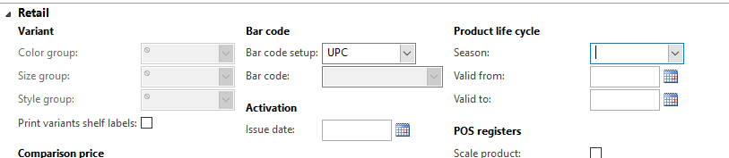

    If you have the Retail Headquarters config key enabled, you will have a "Retail" fast tab on your released products.  There are fields related to this that are used by POS, but no other functionality in the client uses them.  So you should be fine to populate them with your data and make sure you stop the items in DOS at the same time.

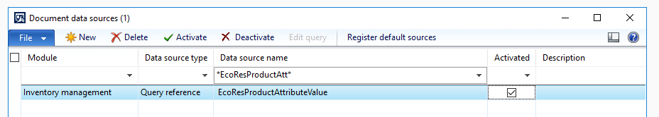

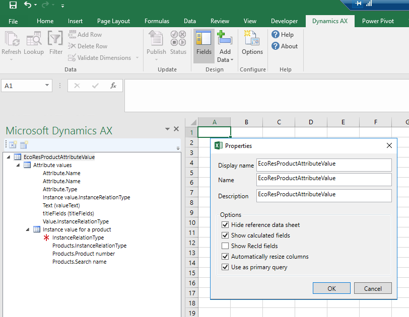

    If you dont have that enabled, you could just add a Product Attribute for Start / Stop sales date.  Once you assign the product attribute to a category hierarchy node, then assign the product to that Category Hierachy node, you'll be able to assign attribute values on the Released product ->  If you want to see them in mass, there is an AOT query EcoResProductAttributeValue that will show you all items and the product attribute values if you expose it to Excel Add-In via Org Admin -> Setup -> Document Mgmt -> Document Data sources.  Once you get it down to Excel, when in design mode, right mouse click on the top level table EcoResProductAttributeValue in the field chooser -> Properties -> tick the "show calculated fields".   The display methods that exist on the tables in the query will get added to the field list in ().

    Enabling the AOT query to show up in the Excel Add-In:
    Enable Computed columns / calculated fields on the query in excel:
