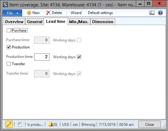

    Hello, we were advised that we could use the Lead Time functionality in Item Coverage to manage the below requirement, but it does not seem to work as desired:
    If we have an item requirement due on a Friday (i.e. sales order requirement to customer), we want MRP to plan to complete the production order on Wednesday, so that we have a day to bundle/build the load and a day to have the truck deliver the load. We entered a Lead Time on Production of 2 working days, as shown below, but there is no change in how MRP plans the order. Is the functionality of the Lead Time in Item coverage different than what was described to us? Is there another way to achieve the desired scheduling scenario outlined above?

    Inside the capacity time fence AX uses the lead time calculated from the route on the item. Review your coverage group that's applied to the item and see if their is a capacity time fence defined. Released Product -> Plan Fast tab -> Coverage Group -> Right click view details -> Other fast tab.
       You can also over-ride the coverage group's capacity time fence on the Master Plan by checking the override checkbox and entering a differing amount of days.  You could check the over-ride and set it to 0 here, then your Item coverage lead time will take effect.  Note this will affect everything that runs through this master plan, so try it out in a test environment first or create a separate plan and run it just for your item.

    Thank you for the reply. The scenario I tested is:
    - Item coverage capacity time fence and explosion time fence set to 20 days
    - production lead time set to 2 days
    - item run time of 1 hour per unit
    - sales order for 3 units due 7/29
    My planned production order thus states a start time of 7AM and end time of 10AM, all occurring on 7/29. We want the planned order to state 7/27 as the scheduled production end date. So essentially we want to bump forward the planned production order by two days. This would allow 7/28 for bundling/packaging the product and 7/29 for the truck to pick up and deliver. It seems there is another setting I am missing in order to have the planned order come through in this manner.

    Set your receipt margin at 2 days on the master plan or the coverage group.

    Thank you, this is what we were looking for!

    There are two separate parts of this issue/topic. The first affects the planned release date for the order, or when you'd normally "firm" it and kick off production. That's affected by the item coverage settings you're showing, so you should probably notice that the order date is correctly winding up about 2 days ahead of the planned receipt date.
    The suggestions to add receipt margin days would affect the planned receipt date, advancing it ahead of the higher level requirement (in this case the sales order). So, for example if you have a margin day of 1 and item coverage of 2 with a sales order due on a Friday, the planned production order would be scheduled for close of business Wednesday, and an order date of 2 days earlier--start of business Tuesday.
    The second issue, though, is the routing steps and scheduling of the work being performed. That's a little harder to establish a fixed leadtime, and is generally a bad idea to try to do so. There are several ways to affect this, including tinkering with capacity time fences, turning on/off finite planning, using queue times, etc.
    What you need to ask yourself is why it's necessary to set a fixed two-day leadtime. Is it because you're not comfortable with the scheduled operations taking so little time that you want to add a buffer? Is it because you're not comfortable with the results of the routing sometimes blowing up and taking too long or not finding available capacity? Is it because the operation steps appear too "lean", with insufficient buffers between process steps? Understanding what root problem will help determine the best approach towards solving this.
