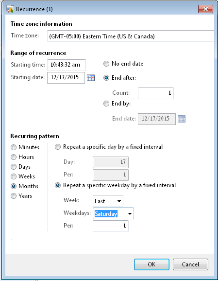

    I don't think there is a magic button. The closest I could find to match what we do is something like this:
    But ultimately, some of our months end on the 1st or 2nd of the next month. This is tricky to set up unless you close every 4 weeks, and I haven't heard of anyone doing that. This may be one of those situations where you just have to set a reminder and run the job manually.
    Wouldn't it be great to have an option under recurrence for "Use Ledger Calendar"? Are the AX Devs out there listening to us?
