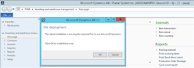

    Whenever logging into AX, the below message is displayed "File Deployment: The client installation is missing the required files to run Microsoft Dynamics.  Click OK to install them now."
    The user can click OK, and the system continues immediately into AX.

      a quick look gave me the following it relates to both a remote desktop and citrix  check it out, it might help, especially if there are isv solutions involved
    File Deployment Client Installation Message When Launching Dynamics AX
    Stoneridgesoftware remove preview
    When launching the Dynamics AX client after a recent Cu9 upgrade, users began receiving a File Deployment message. This message would show up one time in most environments and seem resolved. However, this message was showing up for users every time they launched AX via a published application through Citrix.
    View this on Stoneridgesoftware >

    Thank you, Paul!  Our system administrator found the same posting and it got him on the way to solving the issue.  Appreciate you sharing as well.
